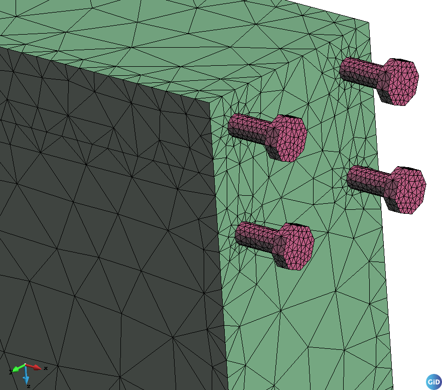

I have attached your model, modified to be like the 2-A) case, including a coarse mesh.

No, my solution that i called ‘2A’ do not use any kind of ‘contact’.
Simply I’ve made that the mesh is continuous between the elements of material ‘concrete’ and the elements of material ‘steel’. The elements are sharing the nodes (because I have created shared surfaces between the geometrical volumes, and the mesh inherit this topology)
It will act numerically like there is glue between the steel and the concrete.
The node is unique, then its main unknown that is the displacement in the FEM simulation F=K*d is the same for both parts.
For other kind of simulations that try to represent a contact with possible relative movement between the parts in contact, must read the ATENA manuals to know how must be defined.
Please ask it to ATENA developers, this forum is for GiD questions (geometry, mesh, postprocessing, customization,…), not for third part problemtype questions.
I have created a video with my operations to have a geometry well connected, without overlapped volumes.
https://youtu.be/vMb_Rc2h_p0
Basically
1-I have used the boolean operation of “substract and intersect”, the result is (A-B) + (A Intersection B)
2-I have re-build the missing part of the bars, creating a cylindric volume by extrusion of a surface with translation.
3-I have used another boolean operation of ‘union’ to merge the cylinders and the head of the bars
4-Finally I have assigned mesh sizes to the curves, surfaces and volumes of the bars, and left the rest with a general mesh size
5-Before generate the mesh, I’ve set 8 threads to mesh faster, and used the ‘Tetgen’ option for volume mesher (this generate the mesh with a Delaunay method, that usualy is fast and robust)
